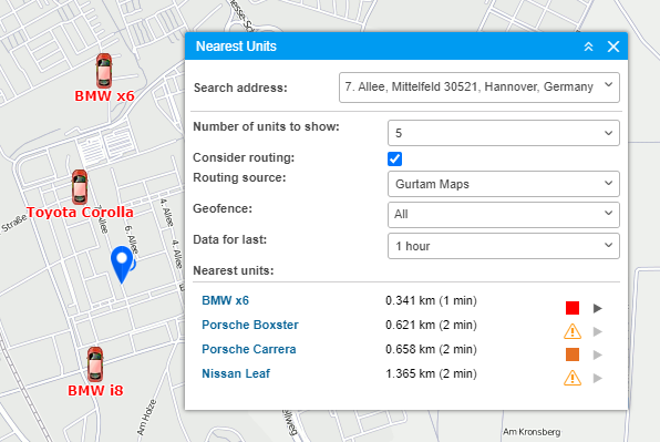

On the Tools tab, select Nearest Units. In a special window, set the parameters of your request and observe search results.
Request
There are two ways to indicate a place.
  • Double-click on the map in this place.
  • Enter an address in the Search field and then choose the most likely variant below.
In the selected place, a red marker appears, and at the bottom, the list of nearest units is displayed.

Search results are presented at the bottom of the window as a list of units. There you can see the following information:
  • unit name (click to focus the map on unit),
  • driver’s phone number (if any driver with indicated phone number is bound to unit),
  • distance to the indicated place (if routing is applied, the first number stands for a distance considering routing and the number in brackets stands for the time necessary to cover this distance, if available),
  • sensor state indicator (adjusted on the Advanced tab of unit properties),
  • buttons to send commands to unit (including messages to driver).
