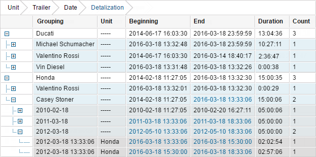

Bindings
The Bindings table shows when and to which unit the driver was assigned, how long his work shifts lasted, how much fuel was spent, the distance traveled, etc.
The following columns can be included in this kind of report.
ColumnDescription
UnitThe name of the unit to which the driver was bound.
BeginningThe date and time when the driver was bound to the unit.
Initial locationThe initial position, that is, the address at that moment (if available).
EndThe date and time when the driver was unbound from the unit.
Final locationThe final position, the address at that moment (if available).
DurationThe duration of a work shift.
Total timeThe time from the beginning of the first shift to the end of the last shift.
Engine hoursThe total amount of engine hours for a working interval of the driver.
Engine hours in movement
The number of engine hours for the interval of movement with the bound driver.
The movement is considered those intervals in which the speed value was greater or equal to the one from the Min moving speed field in the trip detector.
Engine hours in idle runThe number of engine hours for the interval of idling with the bound driver.
MileageThe distance traveled within the period.
Mileage (adjusted)The mileage taking into account the coefficient set in the unit properties on the Advanced tab.
Urban mileageThe distance traveled in the urban area.
Suburban mileageThe distance traveled in the suburban area. It is calculated in regards to speed. The urban/suburban speed line is indicated in Unit Properties —> Advanced (the Urban speed limit setting).
Avg speedThe average speed on a given interval.
Max speedThe maximum speed registered within this work shift.
CounterThe value of the counter sensor.
StatusThe status of the unit registered during the interval (if there are several, the first one is displayed).
ViolationsThe number of violations.
CountThe number of bindings found on a given interval.
ConsumedThe amount of fuel consumed in total for all fuel sensors.
Consumed by...The volume of consumed fuel detected by any fuel sensor (such as impulse/absolute/instant fuel consumption sensor, fuel level sensor) or calculated by math or rates.
Avg consumptionThe average fuel consumption, determined from the available fuel sensors.
Avg consumption by...The average fuel consumption in the trip detected by one of the methods mentioned above.
Initial fuel levelThe fuel level at the beginning of the work shift.
Final fuel levelThe fuel level at the end of the work shift.
PenaltiesThe penalties calculated for the adjusted Eco driving criteria.
RankThe penalty points, converted into a grade using a 6-point rating system.
NotesAn empty column for your custom comments.
In addition, in the report template to the right of the list of columns, you can specify the units to which the report is applied. If no units are selected in this section, the report will be applied to all available units.
The report is designed in such a way that the first column is the list of units to which the driver was bound. It is recommended to apply the detalization option to this table to get a possibility to expand any unit and see more detailed information about all work shift.
To determine the intervals of binding, the messages from the unit are also taken into account. If there are such messages, they are considered to be of more priority than the messages about binding (the intervals are counted according to them).

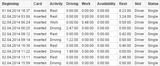

Driver activity
The Driver Activity table shows such information as the type of driver’s action, the crew of a vehicle, the state of the tachograph cards. It may include the following columns.
ColumnDescription
BeginningThe date and time when activity begins.
CardThe state of the digital tachograph (inserted/not inserted).
ActivityThe type of driver's activity (rest, work, driving, available, not available).
SourceThe source of data, which is used to generate information about driver activity. The following column values are available: E — the data about trips is used; T — the tachograph data is used; U — the data about driver unbinding is used; None — the data source is unknown.
UnitThe name of the unit to which the driver is bound.
DrivingThe time of driving.
WorkThe hours of active work (time spent by the driver on vehicle repair, fuel filling, etc.).
AvailabilityThe hours of passive work (time spent by the second driver in the moving vehicle).
RestThe time for rest of the driver (vehicle is stopped, the driver rests in a specially designated place).
Overall workThe total time spent by the driver on such actions as driving, work, reserve.
SlotThe slot for digital tachograph card (Driver or Co-driver).
StatusThe vehicle crew size (single/crew).
Daily mileageThe distance covered by the bound driver during the day (24 hours).

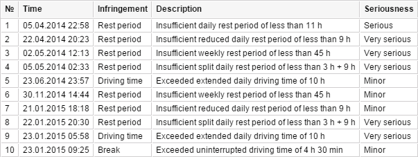

Infringements
This report shows information on the violation of labor routine by the driver. It may include the following columns.
ColumnDescription
TimeDate and time of violation recording.
InfringementType of driver's activity the conditions of which have been violated.
DescriptionA short description of the infringement.
SeriousnessThe extent of the infringement.
QuantityThe number of violations. If the grouping option is activated, this column shows the total number of violations for the selected interval.

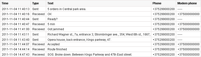

SMS messages
This report shows the correspondence of the dispatcher with the driver via SMS. The dispatcher (operator) can send messages to the driver from the Wialon interface through a special SMS window. The driver sends messages from his mobile phone. This mobile phone number must be indicated in the driver’s properties.
The following columns can be included in the table.
ColumnDescription
TimeThe date and time when the message arrived.
TypeThe message type: sent (message sent by the dispatcher) or received (message received from the driver).
TextThe text of the message.
PhoneThe phone number of the driver.
Modem phoneThe phone number of the modem that sent/received an SMS.

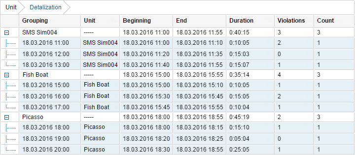

Additional possibilities
For the Binding and SMS messages tables, you can apply grouping by days/weeks/months, but you need to take into account that in these tables only one level of nesting is possible, i.e. at the first level - units, on the second — generalized information for the specified date/week/month (the second level is not disclosed).
