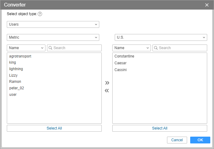

Conversion
The system of measurement for the elements which already exist can be changed with the help of conversion. Only the top-level user can use Conversion. It is available in the interface of the management system. To bring up the conversion dialog, it is necessary to select the corresponding item in the user menu.
In the dropdown list, select the object type (units, resources, users, routes) for which the conversion is made. To the right of the dropdown list, there is a brief description of the actions that a re-performed on the objects of the corresponding type.
Below the object type, select initial and target measurement systems for conversion. For example, if you choose Metric => U.S., a list of elements currently using the metric system is formed below.
From the list, select the objects which should be converted. To add these objects for conversion, use double-click or select an object and press the corresponding button (the arrow pointing right) between the lists. The added objects form the list on the right. To remove items from this list, either double-click them or select and press the corresponding button (the arrow pointing left). To select multiple items, hold the Ctrl key and click on the required items. To perform the conversion of the added items, click OK and confirm your actions in the appeared window. The success of the procedure is reflected in the log.
