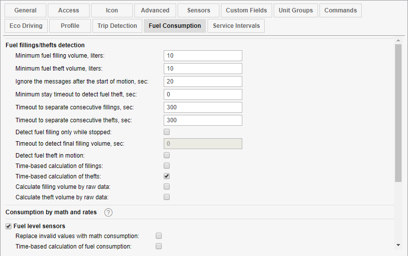

Fuel fillings/thefts detection
Minimum fuel filling volume
The minimum increase of the fuel level that should be considered a filling.
Minimum fuel theft volume
The minimum decrease of the fuel level that should be considered a theft.
Ignore the messages after the start of motion
This feature allows skipping the indicated number of seconds at the beginning of the movement when due to different factors the received fuel level data may not be very accurate. The beginning of the movement is registered when the minimum moving speed set in the Trip detection tab is achieved.
Minimum stay timeout to detect fuel theft
The minimum duration of the interval with no movement, followed by a decrease in the fuel level in the tank for more than the minimum fuel theft volume indicated above.
Timeout to separate consecutive fillings
The system can sometimes detect more than one fuel filling during a short time interval. In such cases, they can be combined in one if the time between them (timeout) does not exceed the time specified in the setting.
Timeout to separate consecutive thefts
This feature is similar to the previous one. Thefts are not summed up if the timeout is exceeded and if the fuel level has increased between them.
Detect fuel filling only while stopped
When this option is activated, fuel fillings are detected only at stops, that is, when the speed of the unit is lower than the minimal speed indicated in the trip detection. This allows reducing the number of false fillings which may be caused, for example, by fuel level fluctuations during the movement.
The initial fuel level is taken from the first message without movement or from the last message with movement.
If you type a certain value in the Timeout to detect final filling volume field, the system also detects fillings during this period after the end of the stop.
in the process of filling there can be interruptions. This option appears if the previous one is selected and allows to set the duration of such interruptions. In this case to determine the fuel level after refuelling, not the last message that corresponds to a filling is used, but the one that follows the indicated timeout.
Detect fuel thefts in motion
Traditionally, fuel thefts are searched during the stops. This feature allows searching for them during the motion, too. For example, it may be useful for ships. However, in many cases, it may cause the detection of false fuel thefts due to probable fuel level differences while, for instance, moving on rough terrain.
Time-based calculation of fillings
It is recommended to use this calculation method for the units with high fuel consumption during the idling (generator, tower crane, etc.). When it is activated, the whole time period is taken into account regardless of trips/stops.
Time-based calculation of thefts
The feature is similar to the previous one, only applicable to fuel thefts.
Calculate fuel filling volume by raw data
With this feature activated, the initial and the final fuel levels on the interval corresponding to the fuel filling are replaced with the values from the messages before applying the filtration. This occurs only when the value from raw data exceeds the value obtained as a result of filtration.
Calculate theft volume by raw data
With this feature activated, the initial and the final fuel levels on the interval corresponding to the fuel theft are replaced with the values from the messages before applying the filtration. This occurs only when the value from raw data exceeds the value obtained as a result of filtration.
