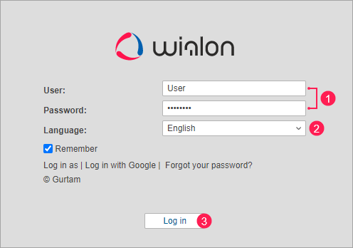

Login
Copied!
Enter the user name and password (1).
Select the interface language (2).
Click Log in (3).
