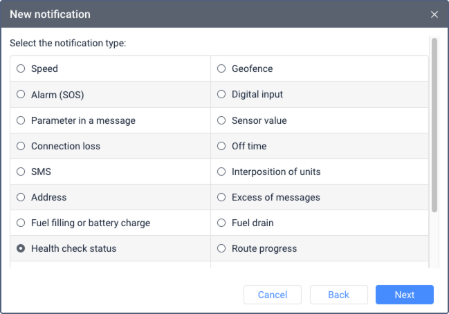

Below are all the possible notification types and the parameters available for them.

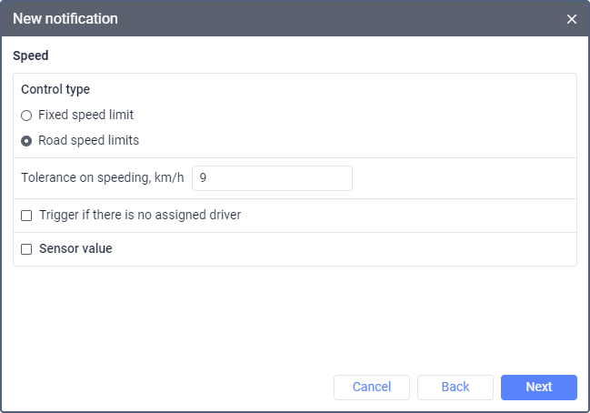

Speed
A notification of this type allows monitoring the vehicle speed.
For this purpose, configure the following options:
OptionDescription
Control type
Available options:
  • Fixed speed limit. The notification is triggered if the speed value is above or below the specified range (the Min and Max fields);
  • Road speed limits. The notification is triggered if the speed limits from maps are violated. For this control type, you can specify the number of kilometers per hour by which the limits from maps can be exceeded (the Tolerance on speeding field).

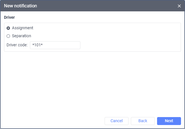

Trigger if there is no assigned driver
If this option is enabled, the notification is triggered if the conditions specified for the control type are met, and no driver is assigned to the unit.
Sensor value
If this option is enabled, there is an additional condition for triggering the notification: a specific sensor value. The option is configured similarly to the notification type of the same name.

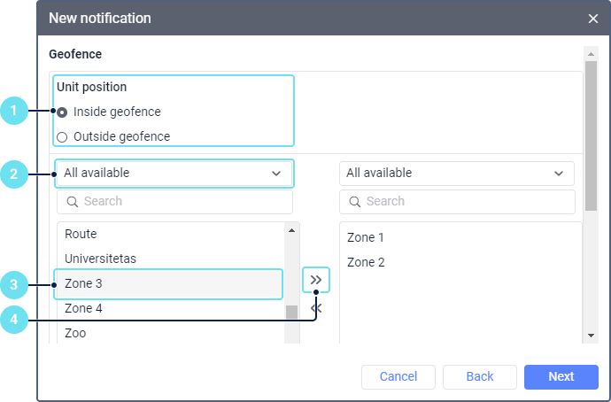

Below are the steps to configure a notification of the Geofence type.
  1. Select when the notification should be triggered:
    • when the unit enters the geofence (Inside geofence);
    • when the unit leaves the geofence (Outside geofence).
  2. Select the resource whose geofences should be displayed in the list (select All available to view the geofences of all available resources).
  3. In the left list, select the geofences or groups of geofences (displayed in square brackets) for which the notification should be triggered. You can use the dynamic filter above the list to search.
  4. Using the icon , move the items from the left list to the right one.

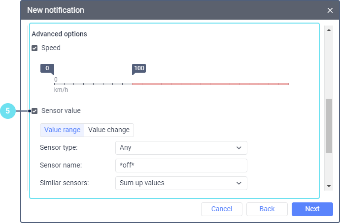

  5. In the Advanced options section, if necessary, specify the additional conditions under which the notification should be triggered:
    • To specify an allowed range of speed values, enable the Speed option and drag the lower and upper range markers. The red part of the scale shows the values at which the notification should be triggered.
    • To specify a range or difference of sensor values, enable and configure the Sensor value option. Its settings are the same as those of the Sensor value notification type.
  6. Select the logical operator on the basis of which the notification should be triggered if several geofences are selected. The OR and AND operators are available.

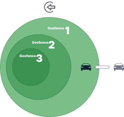

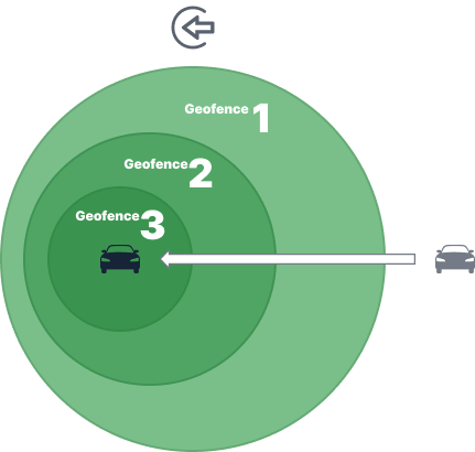

Logical operators for a notification with the “Inside geofence” control type
If the notification controls the entry of a unit into a geofence, the OR and AND operators act as follows.
Logical operatorDescription
OR
The notification is triggered when the unit enters any of the selected geofences.
Example. Geofence 1, Geofence 2 and Geofence 3 are selected in the notification settings. When the unit enters Geofence 1, the notification is triggered. It will also be triggered if the unit enters Geofence 2 or Geofence 3. In addition, the notification will be triggered if the geofences don’t overlap and the unit enters any of them.
AND
The notification is triggered when the unit is in all the selected geofences at the same time.
Example. Geofence 1, Geofence 2 and Geofence 3 are selected in the notification settings. Geofence 3 is inside Geofence 2 and Geofence 1. When the unit is in Geofence 3 and therefore in all the other geofences at the same time, the notification is triggered.

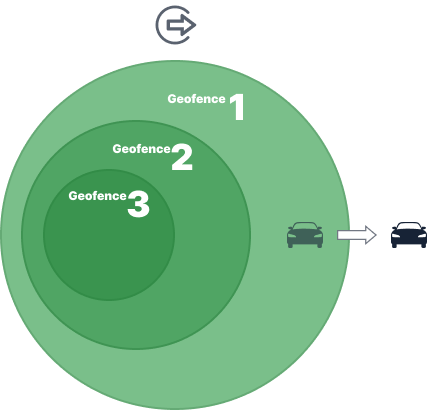

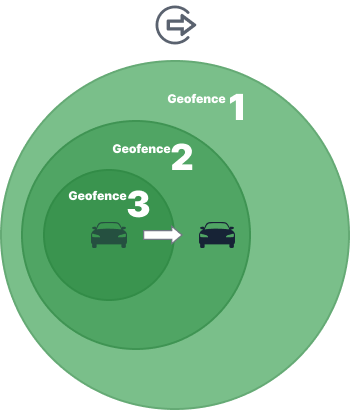

Logical operators for a notification with the “Outside geofence” control type
If the notification controls the exit of a unit from a geofence, the OR and AND operators act as follows.
OR
The notification is triggered when the unit leaves any of the selected geofences if it previously has been in all of them at the same time.
Example. Geofence 1, Geofence 2 and Geofence 3 are selected in the notification settings. Geofence 3 is inside Geofence 2 and Geofence 1. The unit is in Geofence 3 and therefore in all the three geofences at the same time. When it leaves Geofence 3 but still remains in Geofence 2 and Geofence 1, the notification is triggered. The notification is also triggered if the unit moves from Geofence 3 to Geofence 1 or leaves all the geofences at once. If the unit was in Geofence 2 or Geofence 1 and has left them, the notification won't be triggered.
AND
The notification is triggered when the unit leaves all the selected geofences.
Example. Geofence 1, Geofence 2 and Geofence 3 are selected in the notification settings. Geofence 3 is inside Geofence 2 and Geofence 1. The unit is in Geofence 1. After the unit leaves Geofence 1, it is not in any of the three geofences, so the notification is triggered. In addition, the notification is triggered if the geofences don't overlap and the unit leaves any of them.

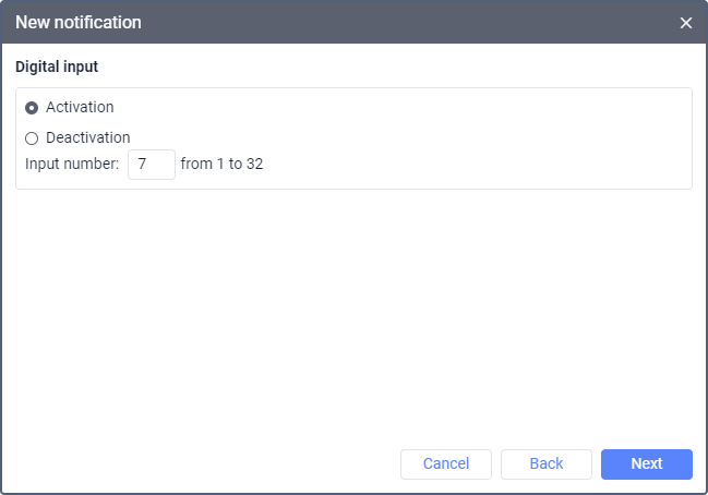

Digital input
A notification of this type is triggered if a digital input of the device is activated or deactivated. To configure the notification, specify the input number on the Activation or Deactivation tab, respectively.
If the message doesn’t have the I/O parameter, the io_n parameter is analyzed.

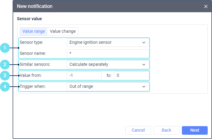

For the Value range method, follow these steps:
  1. In the drop-down list, select the sensor type and/or in the Sensor name field, specify the name mask using special characters (* and ?).
  2. In the Similar sensors drop-down list, select one of the available options:
    • Sum up values. The values of all sensors of the selected type and/or sensors with the same name mask are summed up. Thus, the sum of all values is taken into account before the notification is activated.
    • Calculate separately. The values of all sensors of the selected type and/or sensors with the same specified name mask are controlled separately.
  3. Specify the minimum and maximum values of the sensor. If you need to control a specific value, enter the same number in both the Value from and to fields, for example, from 1 to 1.
  4. Select the activation type:
    • In range. The notification is activated when receiving values which fall in the specified range, including the values specified as minimum and maximum ones.
    • Out of range. The notification is activated when receiving values which don’t fall in the specified range.
For the Value change method, open the same-name tab on the right and follow steps 1 and 2 from the instruction above. In the Delta field, specify a value to trigger the notification when it is exceeded.
Example. The notification should be triggered when the value changes to 1. To do this, 0.9 must be specified in the field.
The sensor values can be increased or decreased because the specified delta is compared with the module (for example, |12 − 10| = 2 and |10 − 12| = 2).

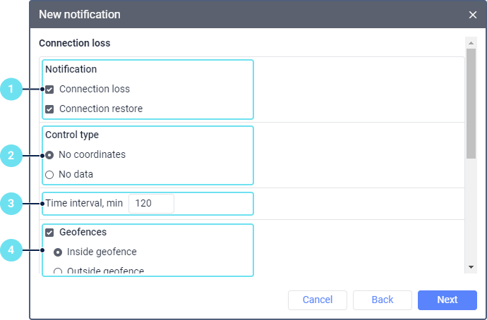

Connection loss
To configure a notification of this type, follow the steps below:
  1. Select when the notification should be triggered: when the connection is lost or restored. You can select both options.
  2. Select in what way the connection loss should be detected:
    Control typeDescription
    No coordinates
    If this option is selected, the connection loss refers to the absence of coordinates in the unit messages or the absence of the messages themselves.
    It may happen that messages with sensor data are sent but they don't contain data on the unit location (for example, if the GPS antenna is closed).
    No dataIf this option is selected, the connection loss refers to the absence of any messages from the unit.
  3. In the Time interval field, specify how long the connection loss should last in order for the notification to be triggered. The maximum allowed value is 999,999 minutes.
  4. If necessary, specify if the unit should be inside or outside a certain geofence as an additional condition for triggering the notification. To configure the Geofences option, follow steps 1–4 from the guide on configuring the notification of the same name.

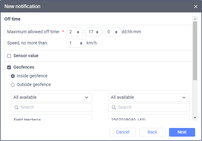

Off time
The notification monitors the unit off time. Off time is a period during which the unit speed remains below a certain threshold.
To configure this notification, adjust the following settings:
SettingDescription
Max allowed off time
Specify for how long a unit can remain stationary before the notification is triggered. This value can’t exceed 30 days.
Speed, no more thanSet the speed threshold below which the vehicle is considered stationary. It is recommended to set this value to 1–5 km/h to account for potential GPS inaccuracies.
Example. The Maximum allowed off time is set to 15 minutes and Speed, no more than, is set to 3 km/h. In this case, the notification will be triggered if the vehicle speed remains below 3 km/h for 15 minutes consecutively. If the vehicle speed exceeds 3 km/h, the 15-minute timer resets to zero and begins counting again when the speed falls back below 3 km/h.
If the Sensor value option is activated, the notification is triggered only if all the specified conditions are met: off time duration, speed, and the sensor value. For example, you can receive notifications when the unit is parked with the engine or attachments running. This option is configured in the same way as the notification type of the same name.
Also, whether the unit is inside or outside a certain geofence can be an additional condition for triggering the notification. For this purpose, enable the Geofence option and configure the settings described in steps 1–4 in the same-name notification type.

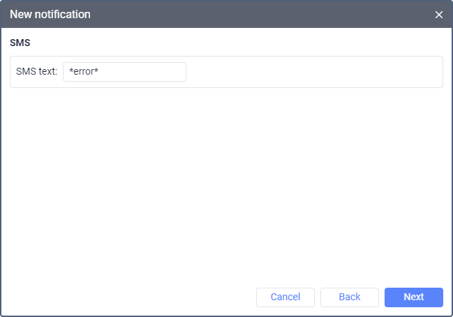

SMS
A notification of this type informs the receiver of getting an SMS message. An asterisk (*) is specified in the SMS text field by default, which means that the notification works for any SMS message. You can specify a mask of a message text so that the notification is triggered only if an SMS message contains the specified text. This may be useful, for example, if the device sends an SMS message with a certain content in case of malfunction.

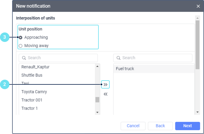

Using notifications of this type, you can monitor whether the units are approaching or moving away from one another.

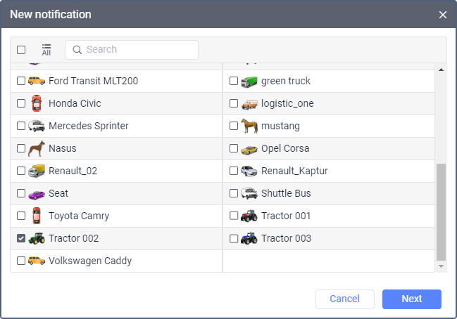

To configure a notification, follow the steps below.
  1. Select the unit or units you want to control from the list.
    The triggered notification indicates that the unit selected in this step approaches or moves away from the unit selected in step 2.
  2. Move to the right side of the window the unit or units that affect the notification triggering taking into account the distance towards them. To find the required unit, use the dynamic search above the list.
  3. Select when you want to be notified: when the unit selected in step 1 approaches another unit or when it moves away from another unit.

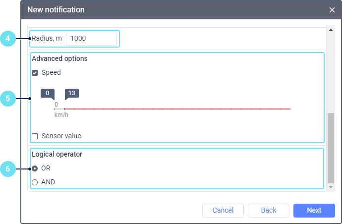

  4. In the Radius field, specify the distance between the units, when the notification should be triggered if the distance decreases or increases.
  5. If necessary, set additional conditions for the notification: speed of the unit selected in step 1 and its sensor value. The latter option is configured in the same way as the notification type of the same name.
  6. In the Logic operator section, select how the specified conditions should be applied in case several units are selected in step 2. Below, you can read about how the AND and OR operators work.

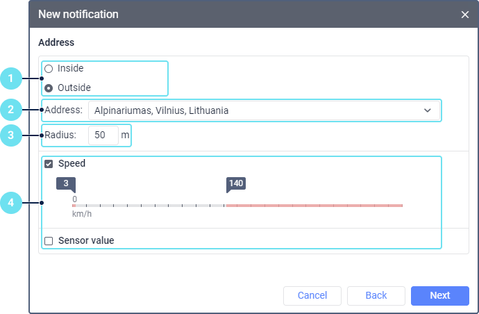

Address
This notification is triggered if the unit is within a certain place or outside it. For configuration, follow the steps below.
  1. Select when the notification should be triggered: when the unit is at the specified address (Inside) or in any other place (Outside).
  2. Start typing the address in the Address field (city, street, house number, etc.) and select the suitable option from the list.
  3. Specify the radius of this point in the Radius field.
  4. If necessary, specify an additional condition: speed and/or sensor value.

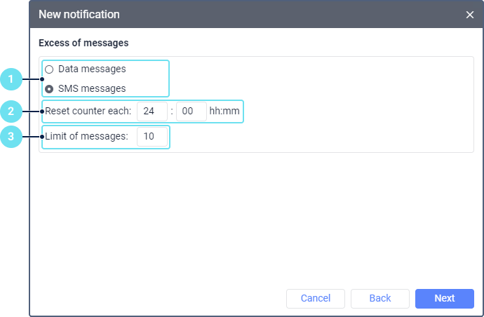

Using notifications of this type, you can control the number of messages received from the unit during a certain time interval. These can be regular messages with data (coordinates, sensor values, etc.) or SMS messages.
  1. Select the type of messages: data messages or SMS messages.
  2. In the Reset counter each field, specify the time interval for which you want to set a limit on messages.
  3. In the Limit of messsages field, specify the number of messages after exceeding which the notification should be triggered.
In the example from the image above, the notification is triggered if 10 or more SMS messages are received from the unit within 24 hours.

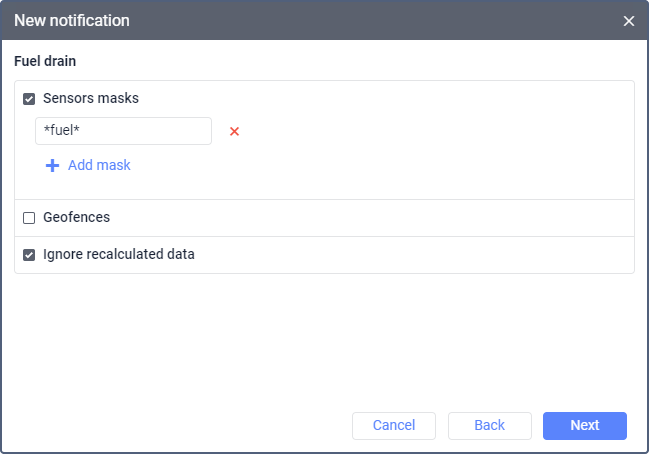

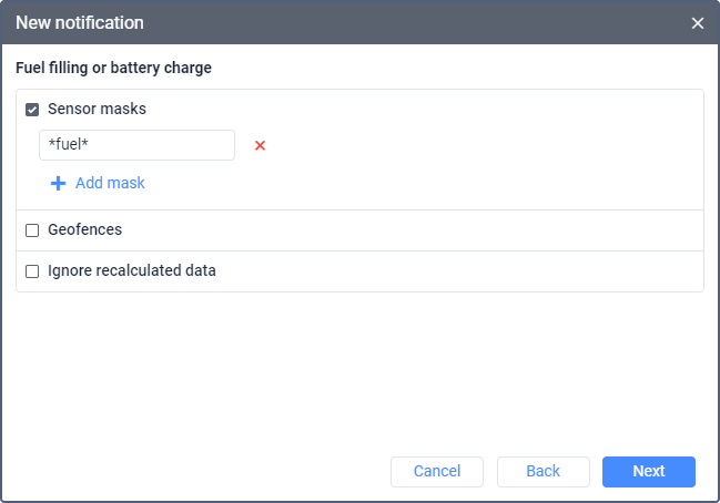

Fuel filling or battery charge
Prerequisites
The Calculate data by the sensor option must be enabled in the settings of the fuel level sensor or in the settings of the battery level sensor.
A notification of this type allows you to monitor fuel fillings or battery charges.
In the Sensor masks option, you can specify one or several masks of the sensors that should be used for detecting fuel fillings or battery charges and their volume.
The notification is triggered for each fuel level sensor or battery level sensor individually.
If the Ignore recalculated data option is enabled, the notification is received only once after a fuel filling or battery charge is detected.
If the Geofence option is enabled, it is an additional trigger condition whether the unit is inside or outside a certain geofence during the fuel filling or battery charge. To configure the option, follow steps 1–4 from the guide to the same-name notification type.
Fuel drain
Prerequisites
The Calculate data by the sensor option must be enabled in the settings of the fuel level sensor.
A notification of this type allows you to monitor fuel drains.
In the Sensor masks option, you can specify one or several masks of the sensors that should be used for detecting fuel drains and their volume.
The notification is triggered for each fuel level sensor individually.
If the Ignore recalculated data option is enabled, the notification is received only once after a drain is detected.
If the Geofence option is enabled, it is an additional trigger condition whether the unit is inside or outside a certain geofence during the drain. To configure the option, follow steps 1–4 from the guide to the same-name notification type.

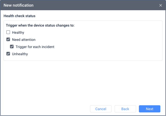

Health check status
Prerequisites
Before setting up the Health check status notification, you need to have:
The Health check status notification allows monitoring the state of the unit device. You can configure the notification triggering when the device status changes to the following statuses.
Status Description
Healthy The notification is triggered when the unit device doesn’t meet any criteria configured on the Health check tab.
Need attention The notification triggers when the incident that meets one or more criteria is registered for the unit device. Enable the Trigger notification for each incident option to generate a notification each time when an incident is registered within the Need attention status.
Unhealthy The notification triggers when all the configured criteria on the Health check tab are met.
The text of the triggered notification indicates the reason for the device status change.
To learn about the past device status changes, you can run the Health check incidents report table.

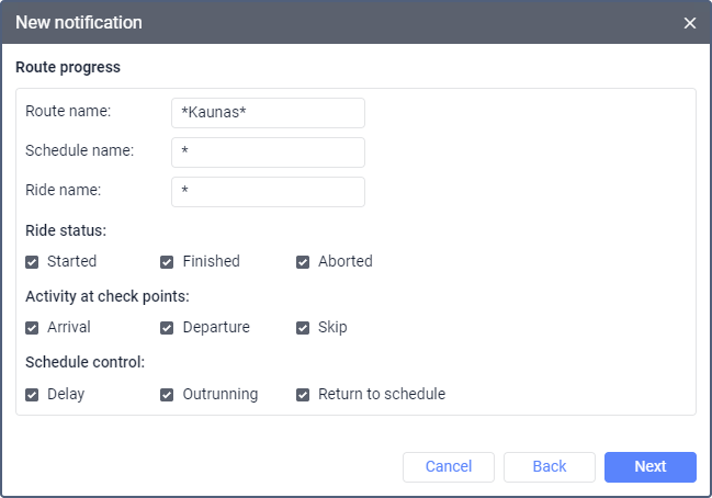

Route progress
Notifications of this type are used to monitor the unit movement along the route. You can receive notifications related to the following route changes:
  • Ride status (started, finished and aborted);
  • Activity at check points (arriving, departing and skipping a check point);
  • Schedule control (delay, outrunning, and return to the schedule).
Additionally, you can specify the name mask of the route, schedule and/or ride.
Driver
Notifications of this type allow you to monitor when drivers are assigned to the units or separated from them.
The Driver code field is available only for notifications about assignments. Here you can specify the driver code or its mask to receive notifications when this driver is assigned to a unit. You can enter several codes or code masks separated by commas without spaces. If an asterisk (*) is specified in this field, the notification is applied to all the drivers.
A notification about separation is triggered if any driver is separated from a unit.

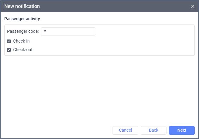

Passenger activity
Notifications of this type allow you to monitor passengers are assigned to the unit (get on) and separated from it (get off).
If you want to be notified of a particular passenger getting on or off the vehicle, specify their code in the Passenger code field. You can enter several codes or code masks separated by commas without spaces in this field. If an asterisk (*) is specified in this field, the notification is applied to all the passengers.

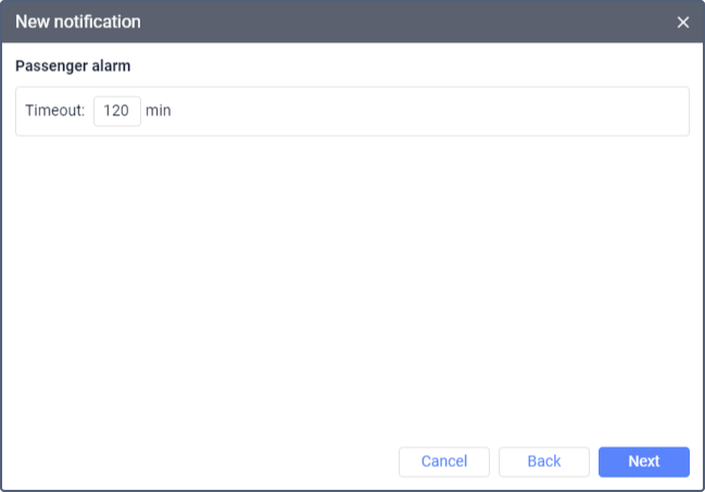

Passenger alarm
A notification of this type is triggered if any passenger of the seleted resource hasn’t got off the vehicle (that is, hasn’t been separated from the unit) within the specified timeout. The timeout is counted from the moment the passenger is assigned to the unit.

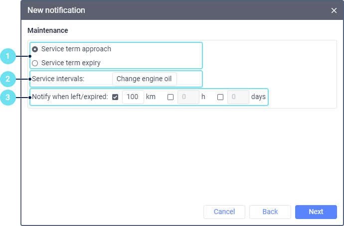

Maintenance
Prerequisites
The creator of the resoure in which the notification is stored needs the View service Intervals access right to the unit.
Notifications of this type are used for the services created on the Service intervals tab of the unit properties.
To configure a maintenance notification, follow these steps:
  1. Select when you want to receive notifications: before or after the service term (the Service term approach and Service term expiry buttons, respectively).
  2. In the Service intervals field, specify the name of the service for which you want to configure the notification. To specify several names, use the name mask. If the symbol * is specified in the field, the notification is applied to all created intervals.
  3. To be notified of the service term approach, specify how many kilometers, hours, and/or days should be left before the beginning of the service term so that the notification is triggered. To be notified of the service term expiry, specify how many kilometers, hours, and/or days should pass after the expiration of the service so that the notification is triggered.
    Example. Vehicle maintenance must be performed every 15,000 km, so a service interval by mileage with a value of 15,000 km has been created for the unit. Also, a notification of the approaching deadline with a value of 1,000 km has been configured. Assuming that the mileage is counted from 0, the notification will be triggered when the mileage is 14,001 km.
The maintenance notification is triggered only once when at least one of the conditions specified in step 3 is fulfilled.
After performing maintenance work, register it using the event registrar or in the unit properties so that the notification term is counted again.
Notifications of this type are not triggered if:
  • you specify a name of at least one overdue service when creating the notification;
  • the unit for which the notification is created doesn’t have any messages with location data.
Also, if the notification is created for several or all service intervals, it will no longer be triggered when at least one of the services becomes overdue.
