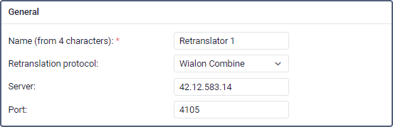

General
Specify the general properties of the retranslator in this section.
The required fields are marked with an asterisk (*).
Field
Description
Name*
Specify the name of the retranslator. It should contain at least 4 characters.
Protocol*
Select the retransmission protocol from the list of available ones.
Server*
Specify the server to which unit messages should be transmitted.

Port*
If necessary, edit the port specified automatically (if this field is available).

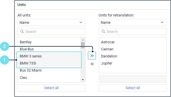

Units
In this section, select units for data transmission. To do this, select the necessary ones in the All units list and move them to the Units for retranslation list using the icon . To select all the units at the same time, click Select all. You can also use keyboard shortcuts to select all or several units at once. To add one unit for data transmission, just double-click on its name.
To find the required units quickly, use the dynamic filters above the lists. The filters work by the following criteria: name, unique ID, device type, and so on. You can select the criterion in the field above the filter.

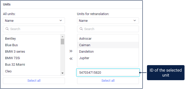

If the unit identifier on the third-party server differs from the unique ID of this unit in Wialon, specify this identifier. To do this, select the required unit in the list of units for retranslation and edit its identifier in the field below the list. The field becomes active after selecting the unit. For transmitting data using the Granit Navigator protocol, the unit identifier should be a number from 0 to 65535. When you specify the unit identifier for the third-party server, the unique ID of this unit in Wialon doesn’t change.
To remove units from the Units for retranslation list, use the method opposite to adding them to this list.
