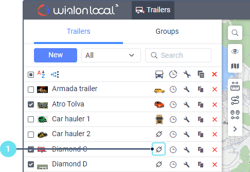

Assigning trailers manually
To assign a trailer to a unit manually, follow the steps below.

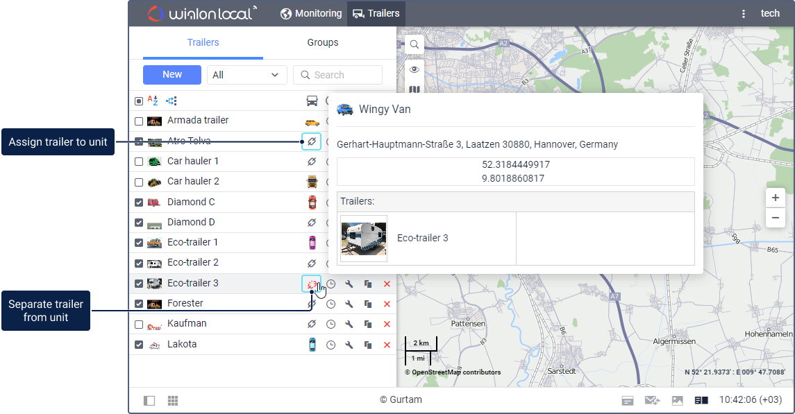

  1. Click on the icon   opposite the required trailer in the list of trailers or their groups. If you don’t have the Create, edit, and delete trailers access right to the resource, the icon is inactive ().

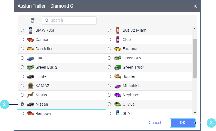

  2. In the open window, select the unit to which you want to assign the trailer. Here you can see the units from the work list on the Monitoring tab. If no units are displayed, click on the icon   to the left of the search. If still no units are displayed, it means you don’t have the View object and its basic properties access right to them.
  3. Click OK.
After that, the icon of the selected unit is shown in the trailer row.
Separating trailers manually
To separate the trailer from the unit, point to the unit icon in the trailer row and click on the icon  .
You can also separate the trailer by registering a new shift for it or by deleting its assignment (see more).

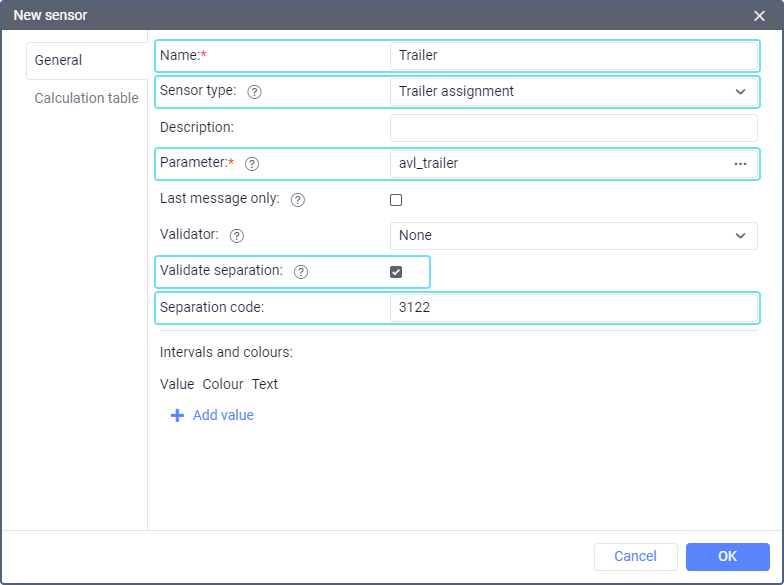

To configure the automatic assignment of trailers to units, follow the steps below.

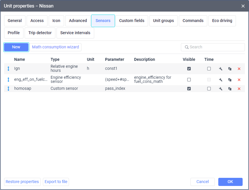

  1. For all the units, to which you want trailers to be assigned automatically, create a sensor of the Trailer assignment type. You can create it in the same way as a sensor of the Driver assignment type.

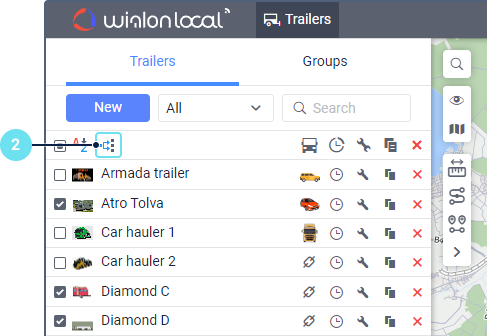

  2. On the Trailers tab, click on the icon  .

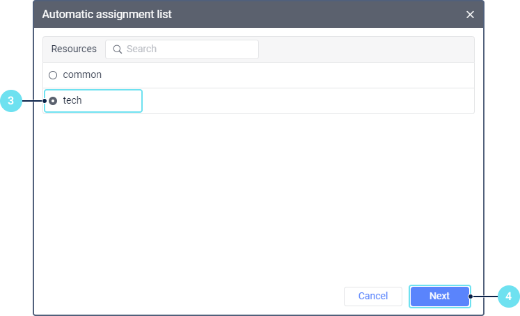

  3. In the list of resources, select the resource for the trailers of which you want to configure automatic assignment. To find out which trailers belong to a certain resource, apply filtering by resource to the trailer list (displayed to the right of the New button).
  4. Click Next.

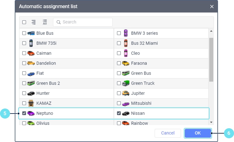

  5. Select the units or unit groups to which the trailers of the selected resource should be assigned automatically. To switch between the lists of units and their groups, use the icon /. For more information about the unit selection, see Creating jobs.
  6. Click ОК.
Separating trailers automatically
The automatic separation of trailers is carried out:
  • after receiving the parameter with the separation code specified in the properties of the Trailer assignment sensor;
Only text or integer parameter values can be used as a separation code. In other cases, the sensor value is rounded and automatic separation doesn’t work.
  • after receiving the parameter with an empty value;
  • as a result of the notification with the Separate trailer action (for example, when turning the ignition off);
  • after assigning another trailer to the unit, provided that the Exclusive option is enabled in the new trailer properties (see more).

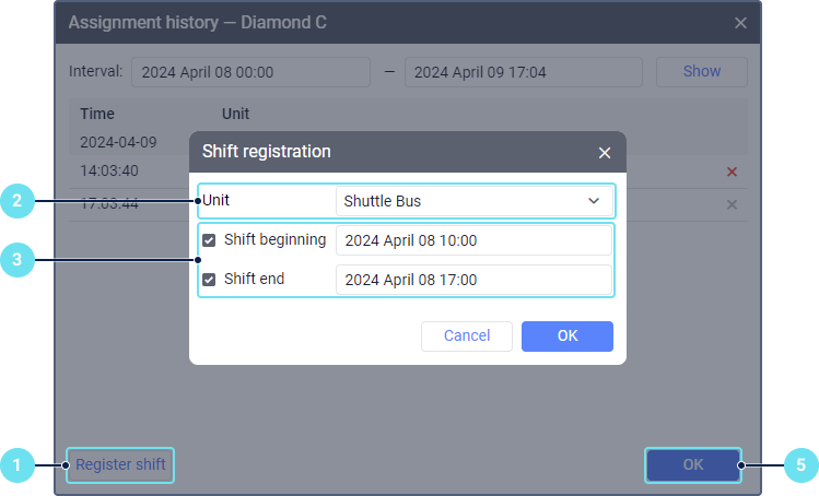

Registering shifts
To create a record of the trailer assignment in the past, follow the steps below.
  1. Click Register shift.
  2. Select a unit in the drop-down list.
  3. Specify the time of the shift beginning and/or end. To enable the Shift end field, put a check mark near it.
  1. Click OK.
