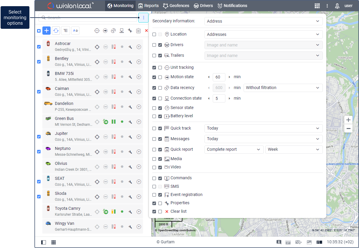

To customize the list, press the icon in the upper right corner of the Monitoring tab. In the left column, select the options that should be displayed in the work list and in the monitoring options menu. In the right column, you can select the options that are used more rarely — they will be shown in the additional menu and will be available there.

All the options on the Monitoring tab are divided into 5 sections. The first one contains the Secondary information option, which allows displaying the contents of the text columns under the unit names. The following alternatives are possible:
- None
- Address
- Geofence
- Driver’s name
- Driver’s phone number
- Trailer
When the private mode of the trip is detected (if the unit has the Private mode type sensor with the Do not show unit location option enabled), the information about the last known location during the previous ‘business’ trip is displayed as the current address or geofence.
