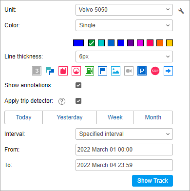

To build a track on the Tracks tab, do the following:
  1. Select a unit in the dropdown list. Its contents depend on the work list on the Monitoring tab and access to the units. In case the work list is empty (when the dynamic work list is used or when units were deleted from the work list manually), the units to which you possess the corresponding rights are displayed.
  2. Adjust the desired parameters for the track (color, thickness, etc.).
  3. Define the time interval within which you want to get the data.
  4. After filling in all the fields, press Show Track.
The principle of interval adjustment is the same as in the reports (see Query and view reports). The third and fourth steps can be combined into one if you use one of the quick intervals (the buttons Today, Yesterday, Week, and Month).

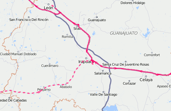

A track or its part can be displayed on the map as a dashed line. Such a situation indicates that the data in this part of the track might be inaccurate. For instance, the maximum interval between the messages is exceeded (see the Advanced tab) or the number of satellites is less than 4 (if the validity filtration of messages is disabled).
The limitation on the number of satellites does not apply to messages with Wi-Fi data, therefore, tracks based on such messages are always shown as a solid line.
