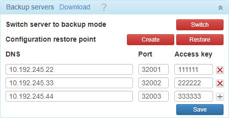

Switch server to back up modeThe option which allows switching the backup server to the primary mode. See more.

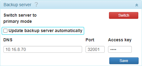

The option is available if the administration system is running in the backup server mode (see the image below) and the backup server has been installed in the /home/wialon/wl_storage_backup directory in accordance with method 1.
If the option is enabled, then when installing an update that contains a backup module, not only the /home/wialon/wlocal/modules/backup folder is updated, but also the software part of the backup server installed in the /home/wialon/wl_storage_backup directory.

Configuration restore point
The option which allows creating a copy of the configuration data and restoring such data.
DNS, Port, Access key
In these fields, you should specify the DNS, port, and access key for each backup server, respectively. These parameters are verified against those specified in the config.txt file of the backup server.
In the image below, you can see the Backup server section of the administration system running in the backup server mode.
