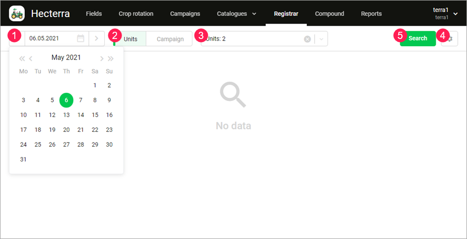

To start the search, follow the steps below.
Select the date on which the work was supposedly performed. If you search by campaign (see steps 2, 3), then only the campaign dates are available in the calendar.
To select the nearest dates, use the arrows to the right and left of the date field. You can also choose a day in the calendar. To open it, click on the date field. Use the single arrows in the calendar to navigate between months, and the double ones to navigate between years.
Select a criterion by which you want to search: unit or campaign.
If no unit is assigned to the campaign, the search by campaign is unavailable.
If you search by unit, specify the name of one or more units (max. 50).
If you search by campaign, specify the campaign name. In this case, on the right, you can see the number and names of the units assigned to this campaign. The date selected in step 1 can change automatically to match the campaign dates. -
If necessary, change the search settings. The settings in this window correspond to the search settings on the Resource tab, but they are applied only during the session.
Click Search.
If the cultivations for the selected date have been found before, but not registered, their list appears on the page automatically.
After making changes in Hecterra or Wialon (for example, after changing the working width of the implement, configuring the fuel consumption, assigning drivers and trailers), you should repeat the search to have the cultivations updated.
On the Compound page, you can combine several cultivations into one under certain conditions.

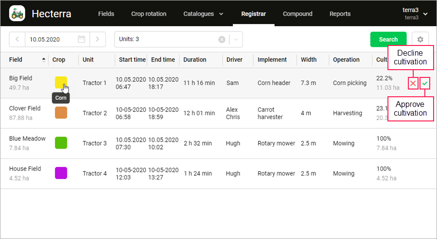

Тable of potential cultivations
The found potential cultivations are displayed in the table with the following columns: field, crop, unit, start time, end time, duration, driver, implement, width, operation, cultivated (the cultivated area). The columns mostly coincide with the properties of the potential cultivation which are described on the next page of the manual.
You can sort the contents of the table by any of its columns. To do this, click on the heading of the required column. The arrows next to the heading indicate the direction of sorting: for direct,
for reverse sorting. To change the direction, click on the name of the column again.
From the table, you can also approve or decline cultivation. To do this, point to the cultivation line and select the required action.
