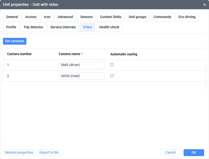

Configuring cameras in the Video tab of the unit properties.
The tab is available in the properties only for the units added to video billing in the CMS Manager.

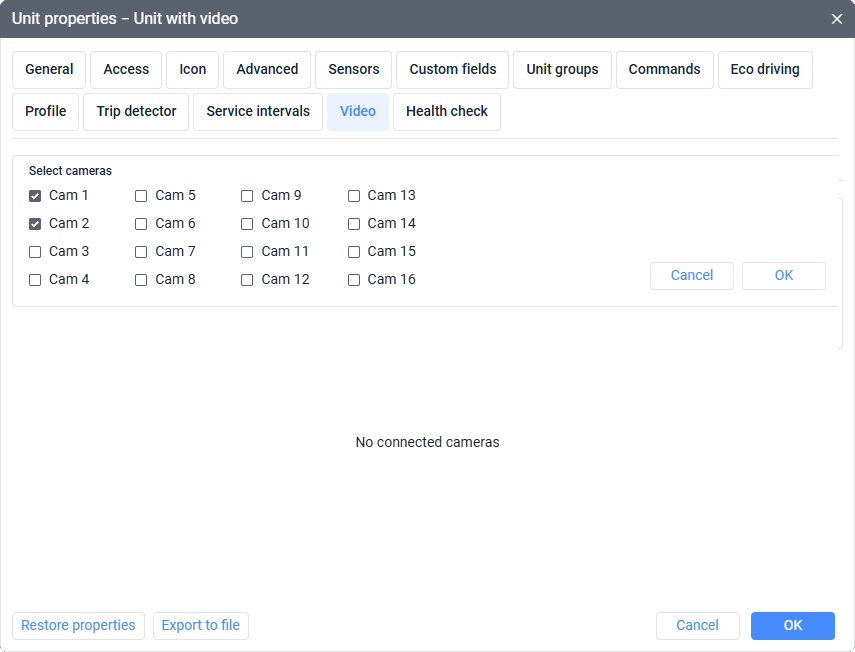

Select the required cameras.

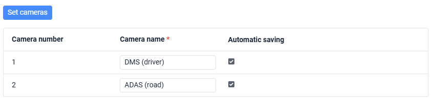

Then, specify their names, making it easier and faster to tell them apart.

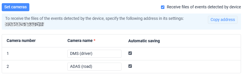

You can also enable the Automatic saving option for the chosen cameras. This feature allows you to automatically save a video when a notification with the Save a video as a file action is triggered. If you do not use such notifications, the status of this option will have no effect whatsoever.
Some devices support recording and sending a video when certain conditions are met (for example, if the driver starts a phone call while driving). If Wialon supports receiving such videos and you want to get them, enable the Receive files of events detected by device option in the upper right corner of the tab. Enabling this option is considered mandatory for Teltonika DualCam and Teltonika DashCam, as well as some other cameras.
Receiving such videos may result in a significant increase in traffic consumption.

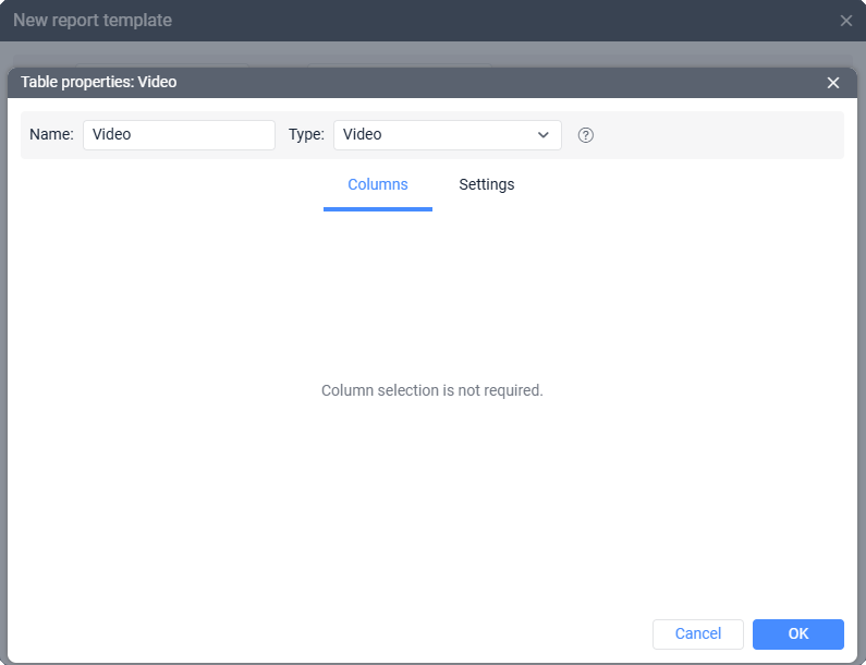

You can view saved video recordings in reports using the Video table.

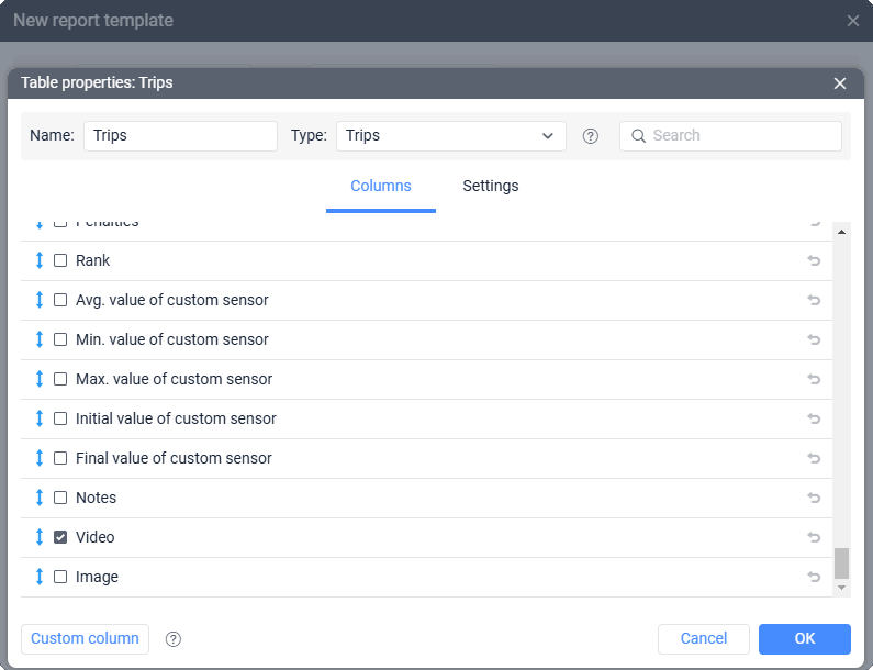

Recordings are also available in the Video column in some tables (for example, Trips, Geofences, Eco Driving, Violations, etc.).
