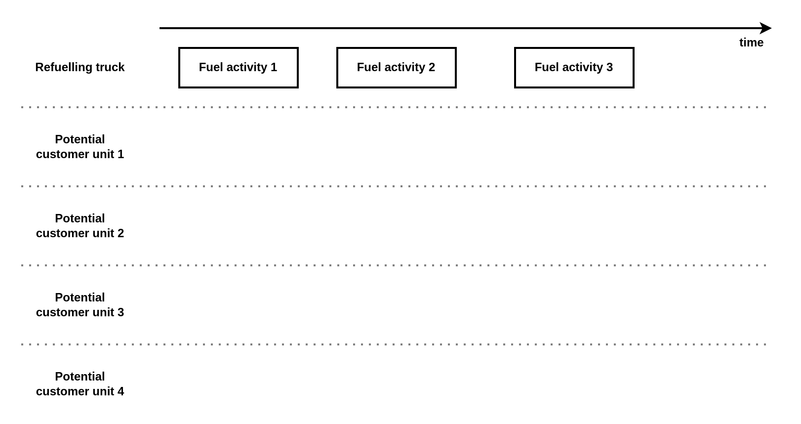

The logic of the table
Let’s take a step-by-step look at the operation logic of the Fuel Traffic table for the case when it is executed for a refuelling truck.
When running a report for the selected interval, the table searches the refuelling truck for Fillingies of various types: fuel fillings, drains, or counter performance. The search is carried out in the same way as in the tables of the same name — Fuel Fillings and Battery Charges, Fuel Drains, and Counter Sensors. It is possible to filter the types of fuel actives to be displayed in the table settings. The logic of working with all three types of activities is the same. For simplicity, let’s assume that only fuel dispensing is considered in the example.

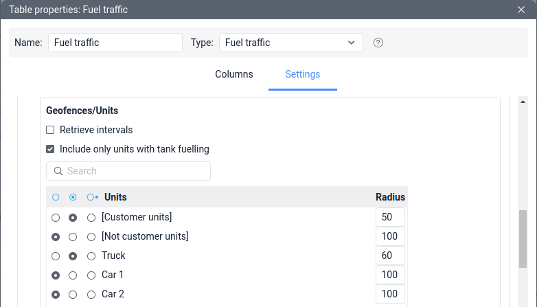

Next, the system looks for potential customers, that is, other units that were close to the refuelling truck during its fuel activities. The distance to these units is compared with the radius of approximation, which is specified in the settings of the Fuel Traffic table. Let’s assume that several such units are found.
The next step, the system starts searching for fuel fillings for the units found nearby. The search is carried out in the same way as in the Fuel Fillings and Battery Charges table.

If the Include only units with tank fuelling option is enabled in the table settings, then units without fillings will be excluded from further analysis and display. And if this option is disabled, then the report will include even those units that were simply near the refuelling truck at the time of fuel activities, but did not have fillings. Let’s suppose that the option Include only units with tank fuelling is enabled in our example.

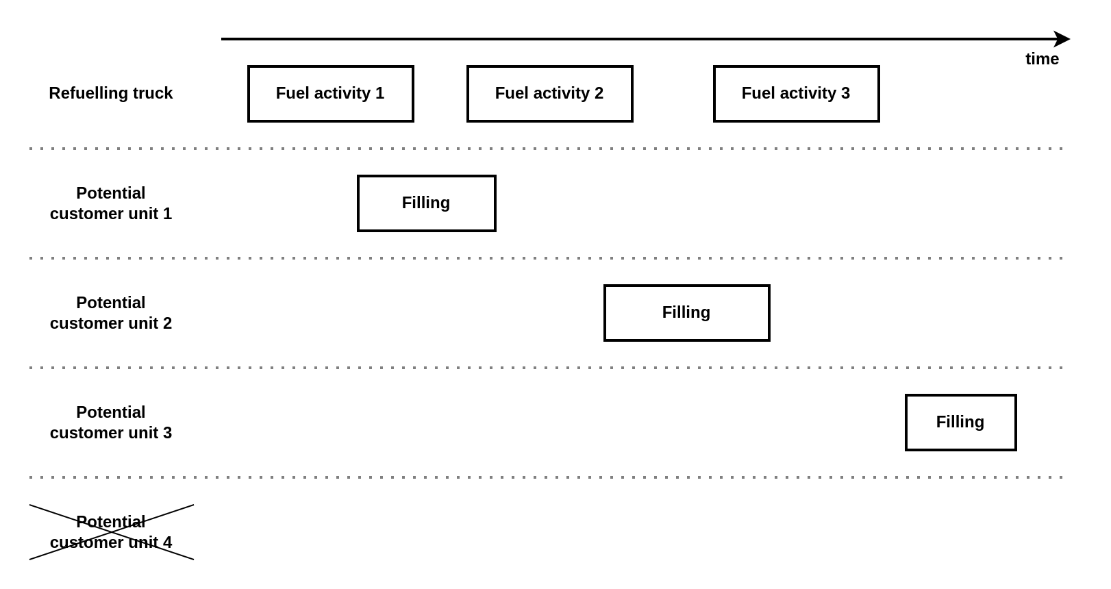

At the moment, the system has already calculated the refuelling truck activity intervals and the filling intervals of customer units. Now we need to adjoin them.
Wialon uses several timestamps when working with fuel fillings:
  • Beginning of the filling — time from the first message of the filling interval.
  • End of the filling — the time from the last message of the filling interval.
  • Filling time — the time indicated in the message after which the maximum increase in fuel occurred in the filling interval. It is this value that is displayed in the Time column in the Fuel fillings and battery charges table.

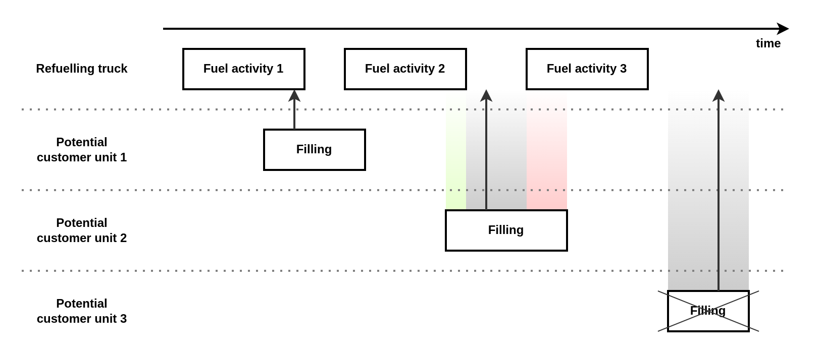

If the filling time of a potential customer falls within the fuel activity, then the filling and fuel activity are considered to be adjacent. If such a hit did not happen, then the algorithm looks for intersections of the filling interval with the interval of fuel activity. If there are several such intersections, then the filling will be adjacent to the first fuel activity in terms of time. If the filling interval does not intersects with any fuel activity, then the customer unit and its filling will not be displayed in the report.
In the example shown in the pictures, we get:
  • The fuel activity 1 row will display the fuel filling of the potential customer 1. In this case, the filling time (maximum fuel level difference) of the customer unit falls within the dispensing interval.
  • The fuel activity 2 row will display the fuel filling of the potential customer 2. The time of this filling does not fall within the dispensing intervals, however, the fuel filling has intersections with several dispensing activities and will be related to the very first one.
  • No fuel fillings will be displayed in the fuel activity 3 row. The filling interval of the potential customer 3 does not overlap with any fuel dispensing.
  • The potential customer 4 will not be displayed in the report. No fuel fillings were detected for it, and according to the condition of the example, the option Include only units with tank fuelling is enabled in the table settings.
The names of the customer units will be displayed in the Geofences/Units column, the Filled column will contain the volume of the customer unit fuel fillings, and the Deviation column will contain the difference between fuel filling and dispensing.
Example of settings for fuel dispensing control

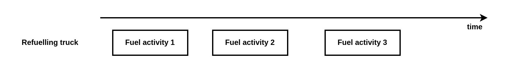

Let’s consider an example of setting up the Fuel Traffic table to control dispensing by a refuelling truck. By default, this table displays all types of fuel activities, so you must first hide the unnecessary ones, and then configure the remaining ones.
Please remember that the settings may vary depending on the equipment used and its accuracy, as well as the needs of the client. However, most of the steps in the instructions below are still the same for all users.

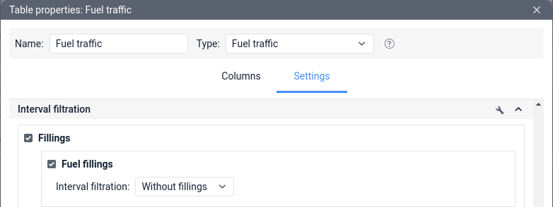

  • To hide refuelling truck fillings, open the Fillings block in the interval filtration, enable the Fuel fillings filter in it, and select the option Without fillings in the drop-down menu.

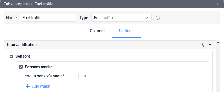

  • If the fuel dispenser does not have a fuel filling gun with flow meter installed, while other counter sensors are created for the unit, they may affect the displayed result. To hide the readings of these counters, open the Sensors block in the interval filtration, enable the Sensor masks filter in it, and specify a name that does not match the names of the counters.
  • If a refuelling truck is equipped with a fuel filling gun with flow meter, it is recommended to work with its data and not with fuel drains detected by the FLS. To hide fuel drains from the fuel dispenser, open the Drains block in the interval filtration, enable the Fuel drains filter in it, and select the Without drains option in the drop-down menu.
  • Depending on the previous steps, at this stage the report will only display the acts of fuel dispensing recorded by the FLS or by the counter. In both cases, to display customer units and their fillings, it is necessary to mark the necessary units or unit groups in the Geofences/Units filter and specify the radius of approximation. This filter is repeated in each of the blocks (Fillings, Drains, Sensors), so you need to configure it in the block that you plan to use. It is also recommended to enable the Include only units with tank fuelling option to hide the units that were just nearby but did not have fillings from the report results.
If several units were found nearby, the report displays the name of the unit with the smallest radius of approximation. If the radii match, then all units are displayed in the report.

This issue may be related to the inaccuracy in determining the location of the refuelling truck or customer units.
You can check location-related tracker configurations or increase the radius of approximation in the settings of the Fuel Traffic table.
