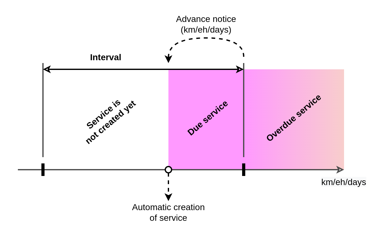

The operation logic of intervals
It was previously mentioned that Intervals can be considered as templates for creating Services.
The properties of Intervals indicate the periodicity, which can be determined by mileage, engine hours, days, or several of these indicators simultaneously. For example, a passenger car may be subject to inspection once a year, either when passing 20.000 kilometers, or when operating 300 engine hours — when any of these indicators is reached, it is necessary to check the unit, after which 365 days, 20.000 kilometers or 300 engine hours will be counted again until the next check.
The car inspection itself is called a Service in Fleetrun terminology, and it is the main element that the fleet engineer works with in Fleetrun. At the same time, the Service is not displayed in the application immediately, but when for any of the indicators a certain number of days/kilometers/engine hours remain until the end of the Interval. This number is specified in the Advance notice field in the Interval properties.

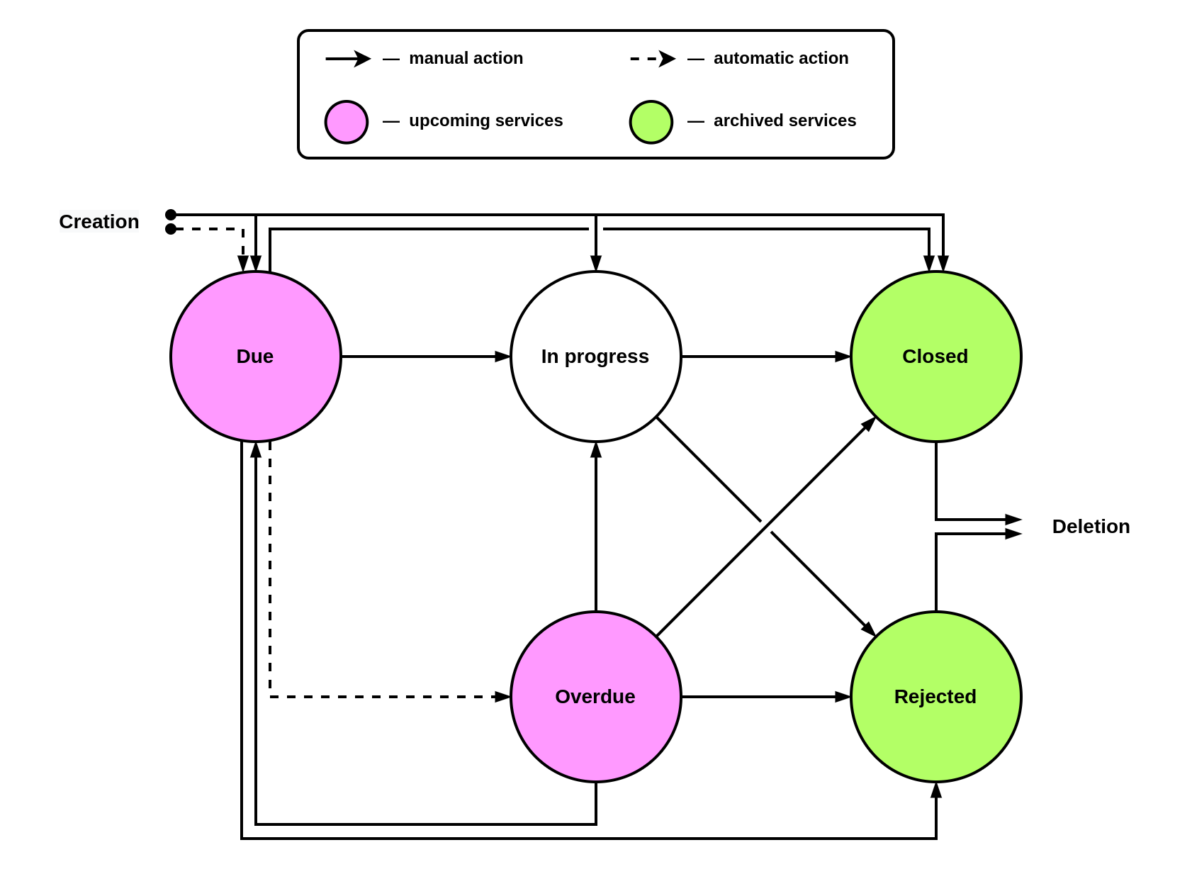

Let’s consider the logic of changing statuses using several diagrams. This type of diagrams is called a directed graph, and it is convenient for describing one-way relationships, exactly what we need in this case.

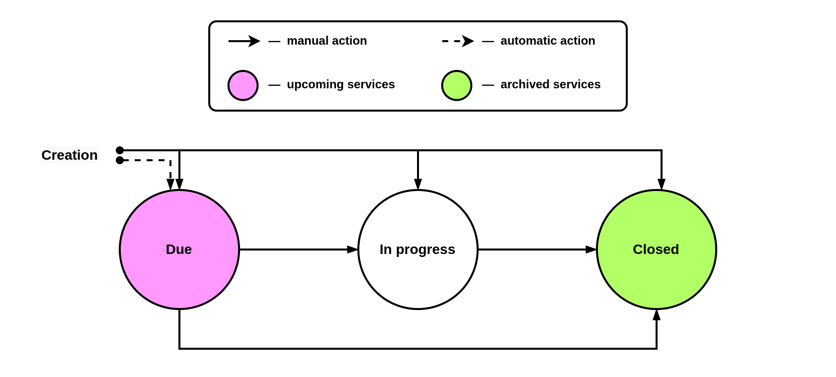

Ideally, services in Fleetrun go through only 3 statuses: due → in progress → closed. They can be represented schematically as follows.
However, the real situation is often more complicated, so you have to use all 5 statuses. In this case, you should consider some features of their change:
  • Almost all actions with statuses are done manually. The only exceptions are the automatic creation of the Service based on the Interval and the transition from the due status to the overdue one.
  • You can create a service in almost all statuses, except for overdue and rejected, since such an action would make no sense.
  • There is no need to delete the Service after work completion. However, if this is required, then first it will have to be completed or rejected.
A comprehensive diagram for changing statuses will look like this.
